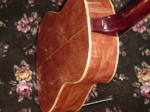

Are there very many Forumites using these products? How are they to apply? Are you satisfied with the finished product. I used KTM4 on a guitar but did not like that it didn't burn in. I have ordered this product to finish an OM I will soon be putting together. I know that nitro-cellulose works well but what a smell(hard on the brain).
Has anyone used the silica powder mixed with the epoxy?? How's the application process?? Any pointers or tips. I know LMI has a small blurb on website. Thought I would try and get first hand explanations. Appreciate any thoughts or comments.

I think you will like KTM9 I can find no fault with it. In answer to the second question, I have used silaca beads with zpoxy but in my opinion it is not needed for a good fill on even the most open grained woods. And bye the way, Zpoxy really makes the wood pop under finish.

Ron I have used both. The Z-Poxy works great as a filler and grain popper, sands easy. I didn't use the silica filler. KTM-9 worked great for me. Some say it doesn't dry hard but I didn't find that at all. As a matter of fact I waited about a month before buffing because I was busy on some other project and it was harder to buff out than PSL that I had used before. I am going to try Target Coatings new product that Mario did extensive testing on. He likes it and thats good enough for me.
